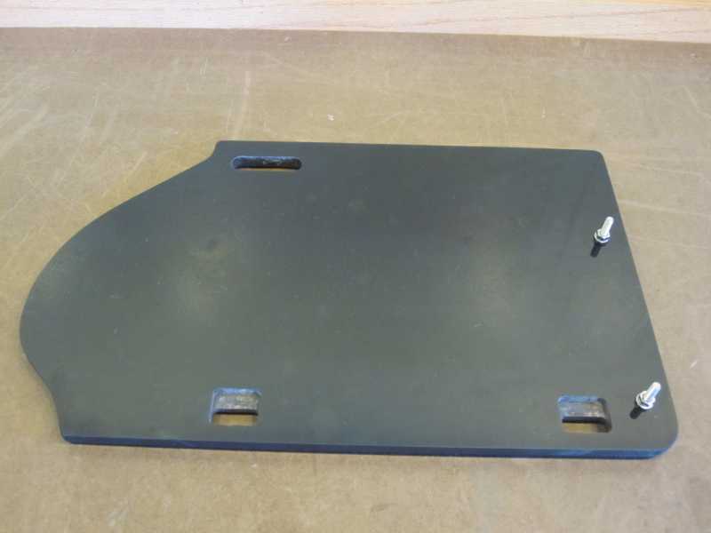

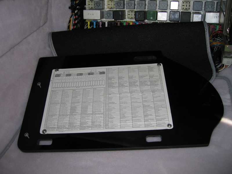

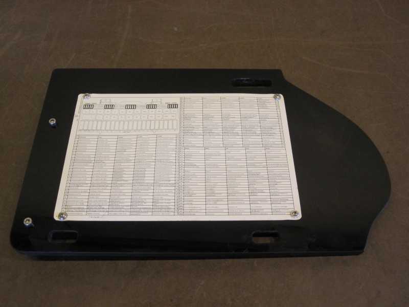

One can only wonder why Porsche made the fuse and relay cover out of the poorest plywood material.
They could have made it out of marine plywood if they were going to use plywood at all!
That's now been remedied by using 7/16" delrin material. See three attached pictures
