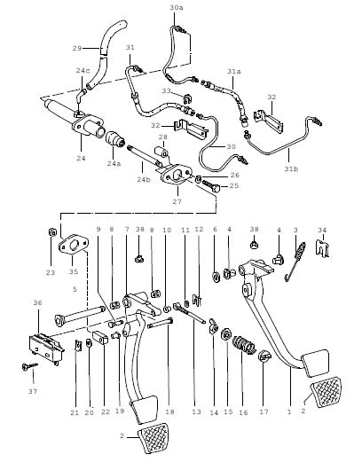

To many the manual shift 928 is the highly desired model. The clutch system for the manual shift is hydraulically operated. The source of the fluid is the brake master cylinder reservoir. A hose from the brake master cylinder transfers the fluid to the clutch master cylinder.
My manual shift Porsche 1979 928 diagnostic warning light flashed “brake fluid” when I turned on the ignition switch. I did see a puddle of something underneath the car. I popped the hood and observed that the hose that furnishes brake fluid from the reservoir to the clutch master cylinder was seeping fluid. It had drained enough brake fluid from the reservoir to trigger the warning light. I refilled the reservoir, double checked that the brakes worked properly and drove to my Porsche mechanic, Dan at Exotic Motorwerks for repair.
The brake fluid hose is labeled 29 in the diagram above.

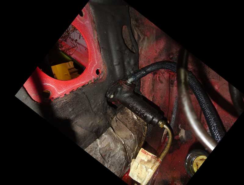

In the photo above, the hole in the firewall is where the power brake booster is located.

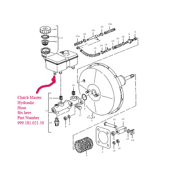

Porsche Hydraulic Fluid Hose Part Number 999 181 021 50
