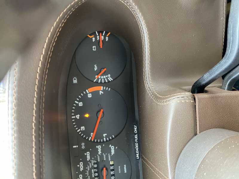

I have a flashing arrow on the tachometer under the 4. It goes on and off apparently without cause or reason. . I don’t see anything in the owners manual about it. Thank you

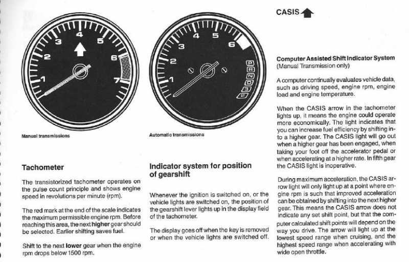

The owners manual describes Computer Assisted Shift Indicator System (CASIS) for manual transmission only.
This explains all about the arrow and how to interpret what CASIS is indicating.
