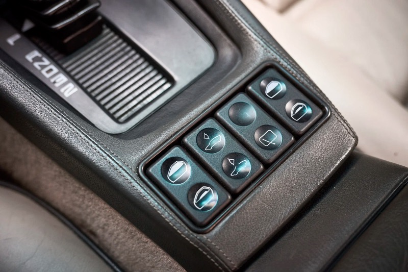

Hi,
Would anyone have a 92855231350, Porsche part number for a center console switch bezel frame for sale. This was used in factory supplied leather consoles, however mine is an after market leather conversion and does not have the satin black switch bezel frame. I have attached a picture so the part is clearer. Also looking for recommendations to replace the switches as over time the white lettering is getting less visible. This would be the two window, rear window and sunroof.
928 S4 1989 Left Hand Drive
Based in the UK
Based in the UK
1 month 3 weeks ago #23163
Replied by Rich928 on topic 92855231350 center console switch bezel
There are no switch cover replacements, the entire switch must be replaced.
Porsche 928 Window Switch Part Number: 928 613 123 05 (same for each side)
Porsche 928 Sun Roof Switch Part Number: 928 613 120 00
There are OEM and there are aftermarket switches that are less expensive however quality and functionality may vary. The switches connect to the wiring harness quite a ways away deep into the dash. I've see hack jobs where the wires are just cut and soldered near the switch, this is not the way to do the job. Replacement switches must be "re-pinned" into the existing plastic connector.
1 month 3 weeks ago #23164
by GKEJ
Replied by GKEJ on topic 92855231350 center console switch bezel
Thank you Rich
